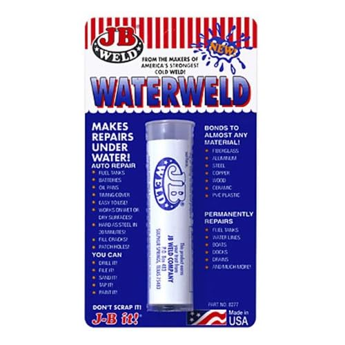

OK, I bought some J-B Water Weld to repair a fuel tank on a mower last year and it worked great. This stuff is like epoxy putty which you mix up by kneading in your hand. It has the consistency of play-doh and you can shape it and sculpt it easily. It doesn't run or sag, dries hard, and is very strong:
http://www.amazon.com/J-B-Weld-8277-Water/dp/B000BRQ0TW/ref=pd_sim_auto_3

I got this! I played around with it on a piece of plastic quarter round moulding that had a chip. I found it a bit hard to work with...sticky. Any tips on how to force it into the missing chunk and smooth it out.
