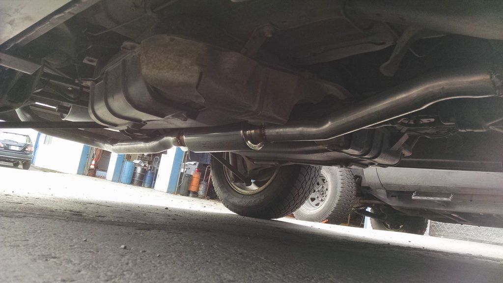

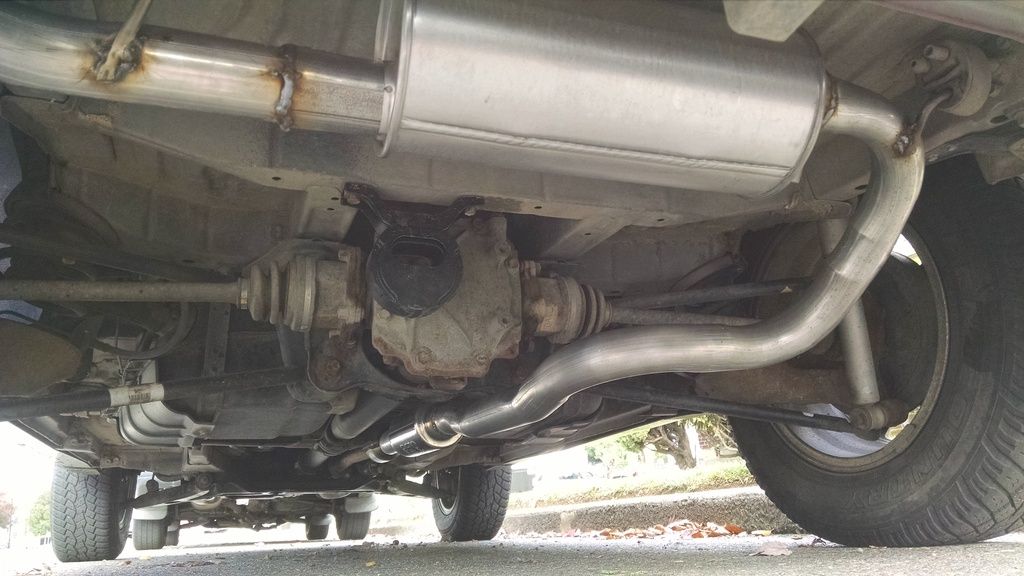

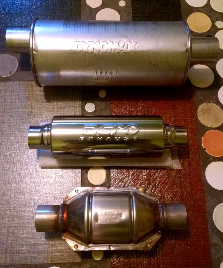

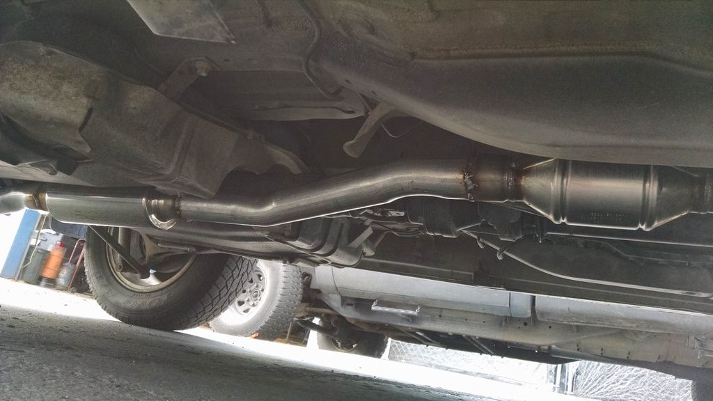

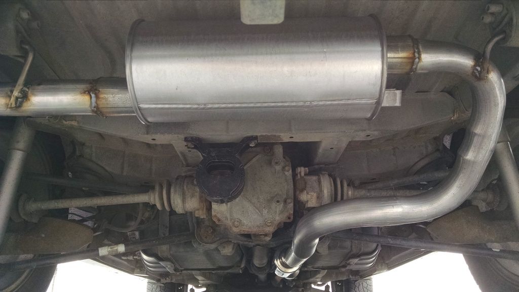

Just had my custom exhaust done today, 2.25" piping back, replaced the secondary cat with a Vibrant Performance high-flow cat to an Aero Turbine resonator, out to a DynoMax Super Turbo muffler. Very happy with the results.
My goal was to make it slightly louder than stock but gain performance from the larger diameter piping. Mission accomplished! Very deep growl, no raspiness or high pitch tone. Dare I say...sounds a little Subaru like. Will post sound clips after I drive it for a week or two to break everything in.

Muffler was $57 shipped from Amazon, resonator $30, catalytic converter was $25 shipped from Amazon but normally $80. I happened to check it out online one day and they had one left for $25 shipped and I snatched that up.
The shop I went to charged me $200 for piping and labor. So overall total is about $315. Not bad in my opinion.

It looks like a good install. Good clearance from underside and plenty of supports.
If it works as good as it looks, you might recommend the shop.

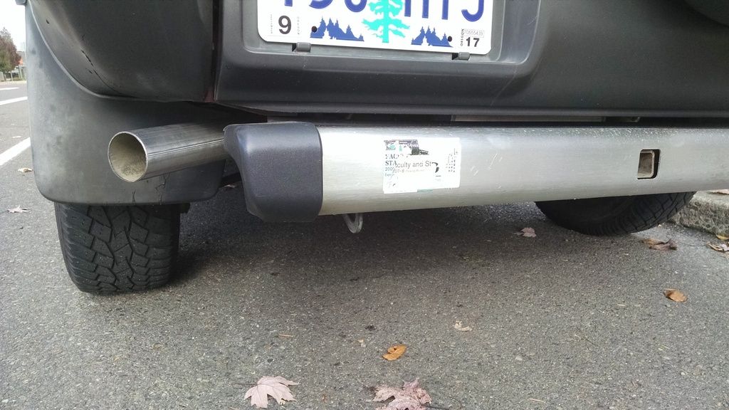

Very nice. Now if you can just get rid of that sticker on the tow hitch thing.

Hard to tell at first. Is that stainless steel or aluminized steel.
They did a good job on the welds by the look of it. And mandrel bending is the best.
