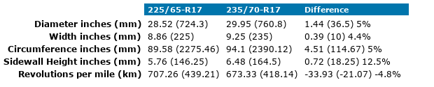

I'd like to upsize my '13 XLE tires from 225/65/R17 to 235/70/R17. They're about 1.5" larger in diameter.
I'm primarily interested in the added ground clearance and increased sidewall height. I'm aware of the disadvantages of using a larger tire.
Has anyone confirmed that 235/70/R17 tires fit without rubbing?
G
Based on a tire size calculator, the speed difference between the tires is 3 mph.
If your speedometer shows 60 mph (with new tires), you will actually be going 63 mph.
But since most of the speedometers are a head by about 3 - 4 mph, it will very close to accurate (meaning 60 mph on the speedometer will actually be or very close to 60 mph).
