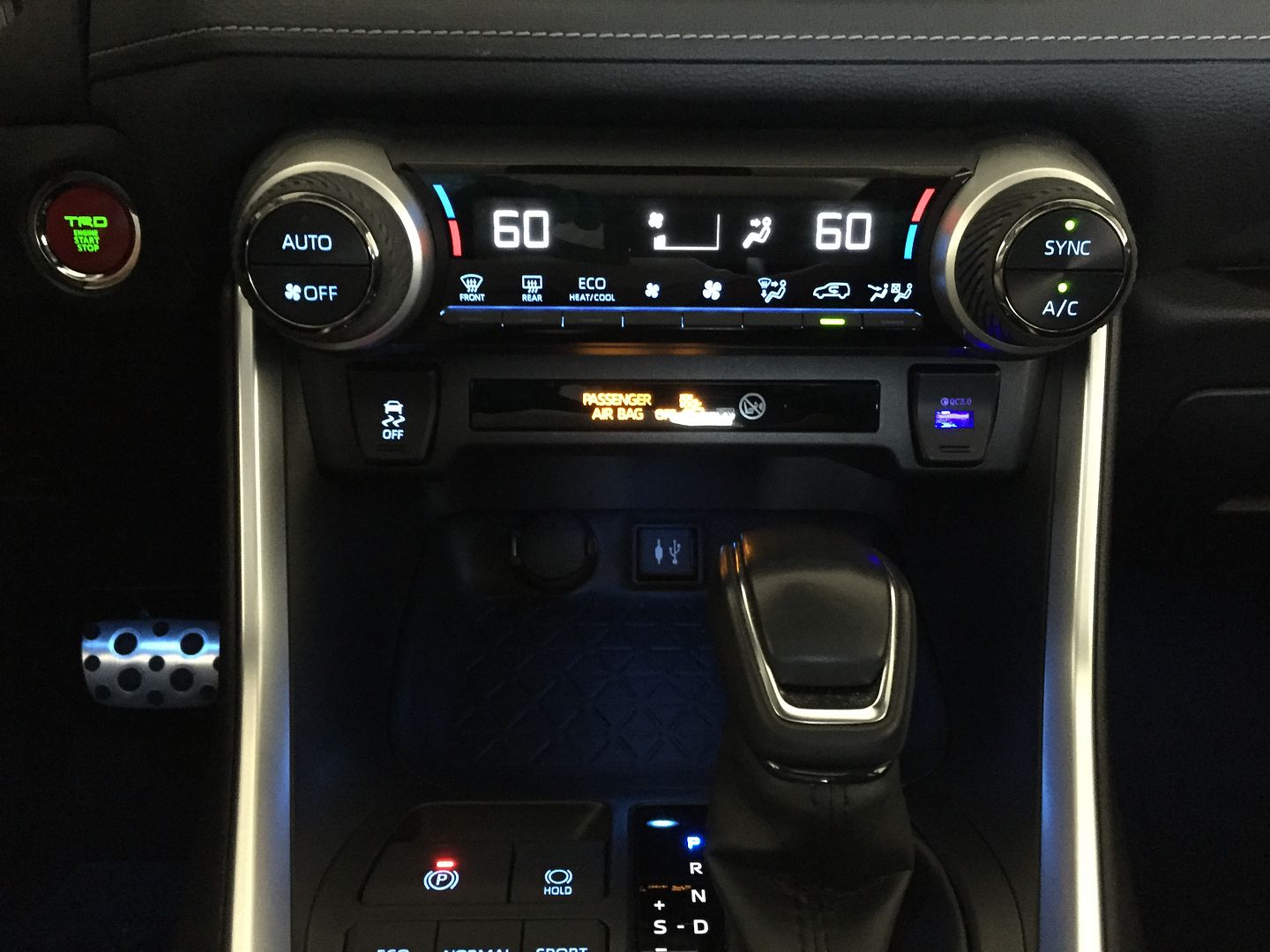

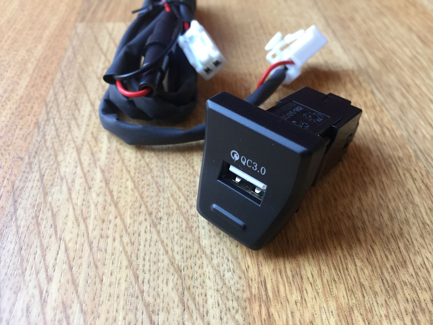

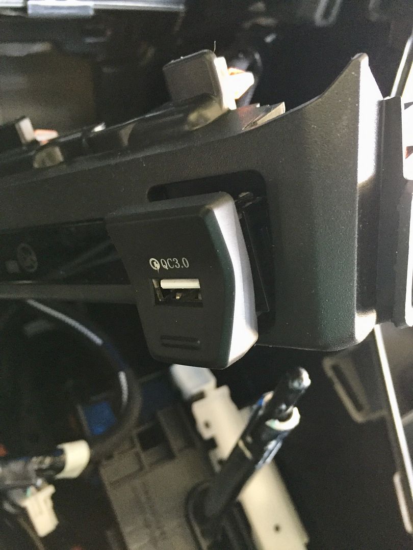

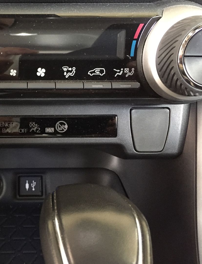

Finally found an upgrade to this plain jane switch blank cap on the center control panel:

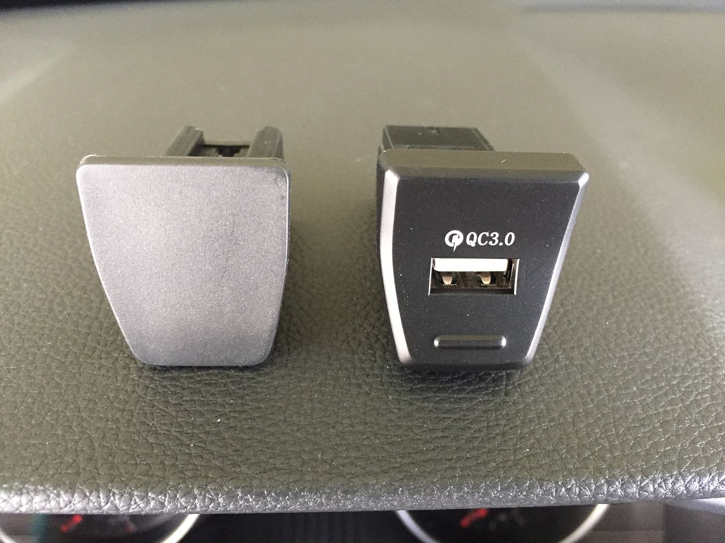

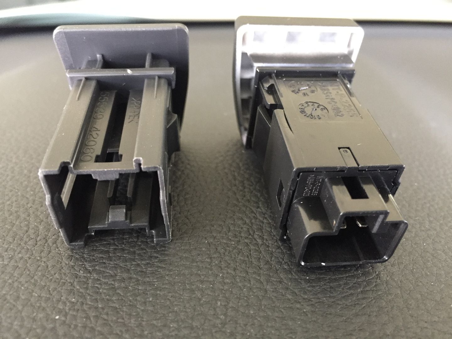

The Part Upgrade: From Homie Auto parts/Ali Express

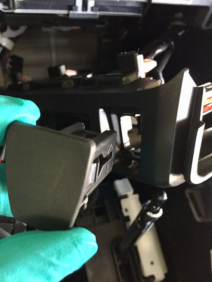

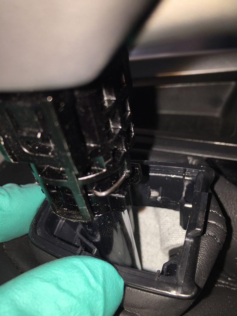

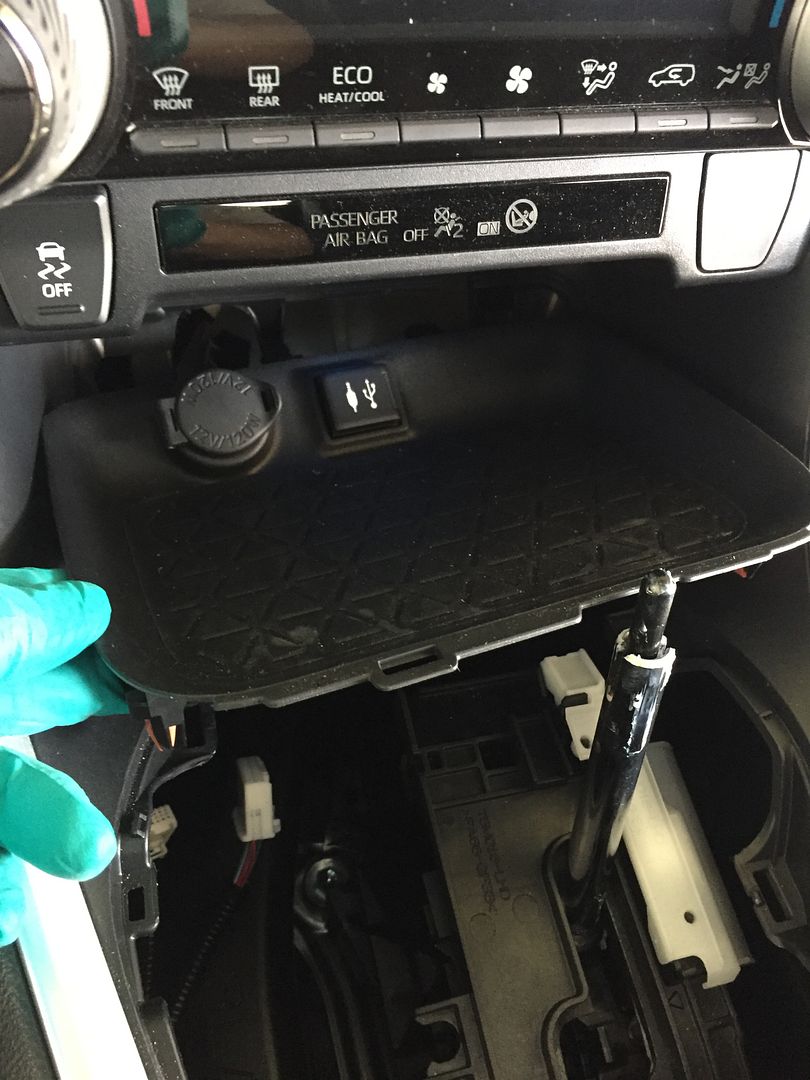

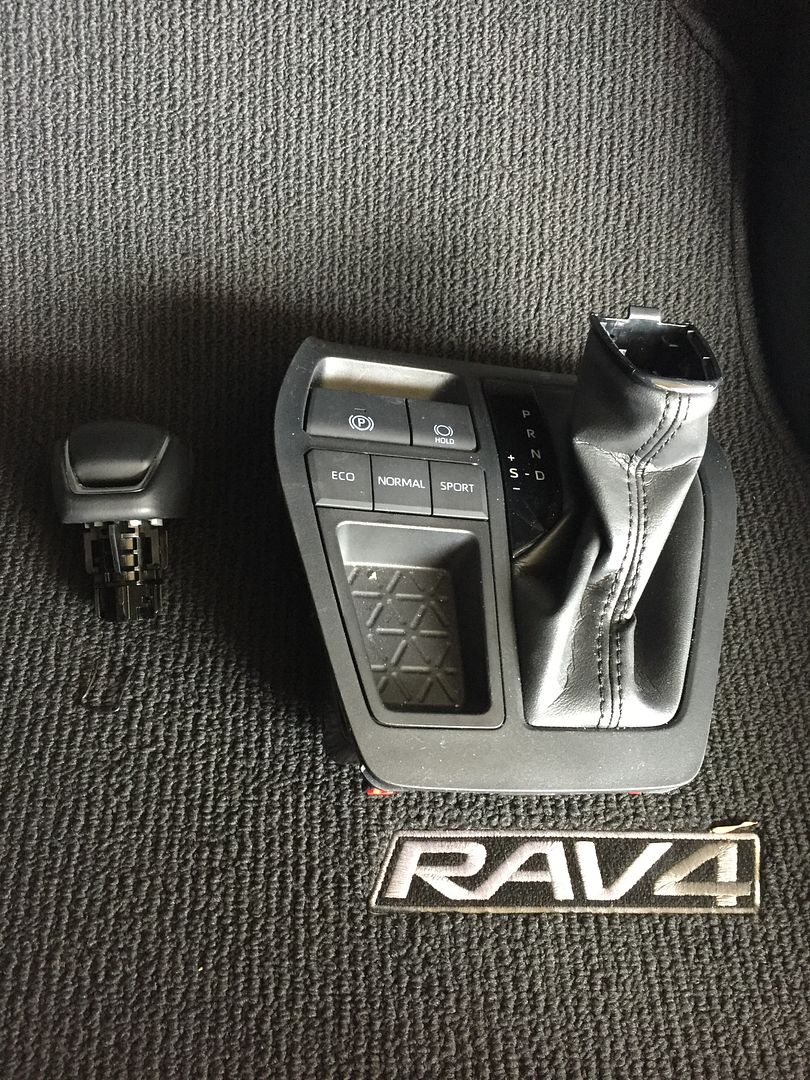

To install remove the AC control panel, Shifter Panel and Trim, Shift Knob, Console Pad:
Pull out the center control panel, pop out the blank cap has two tabs on the side, push tabs the push out the cap:

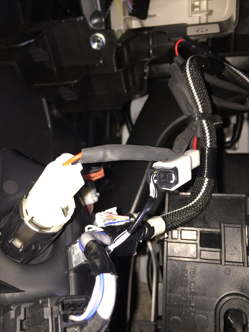

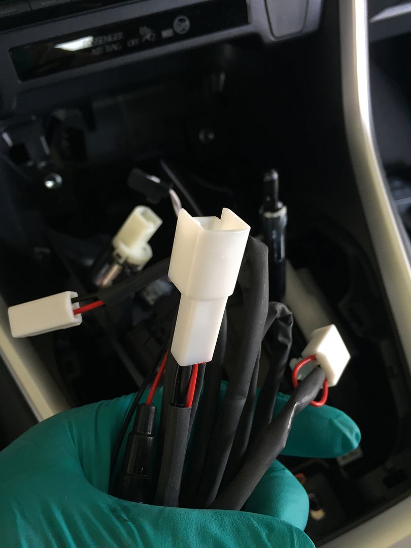

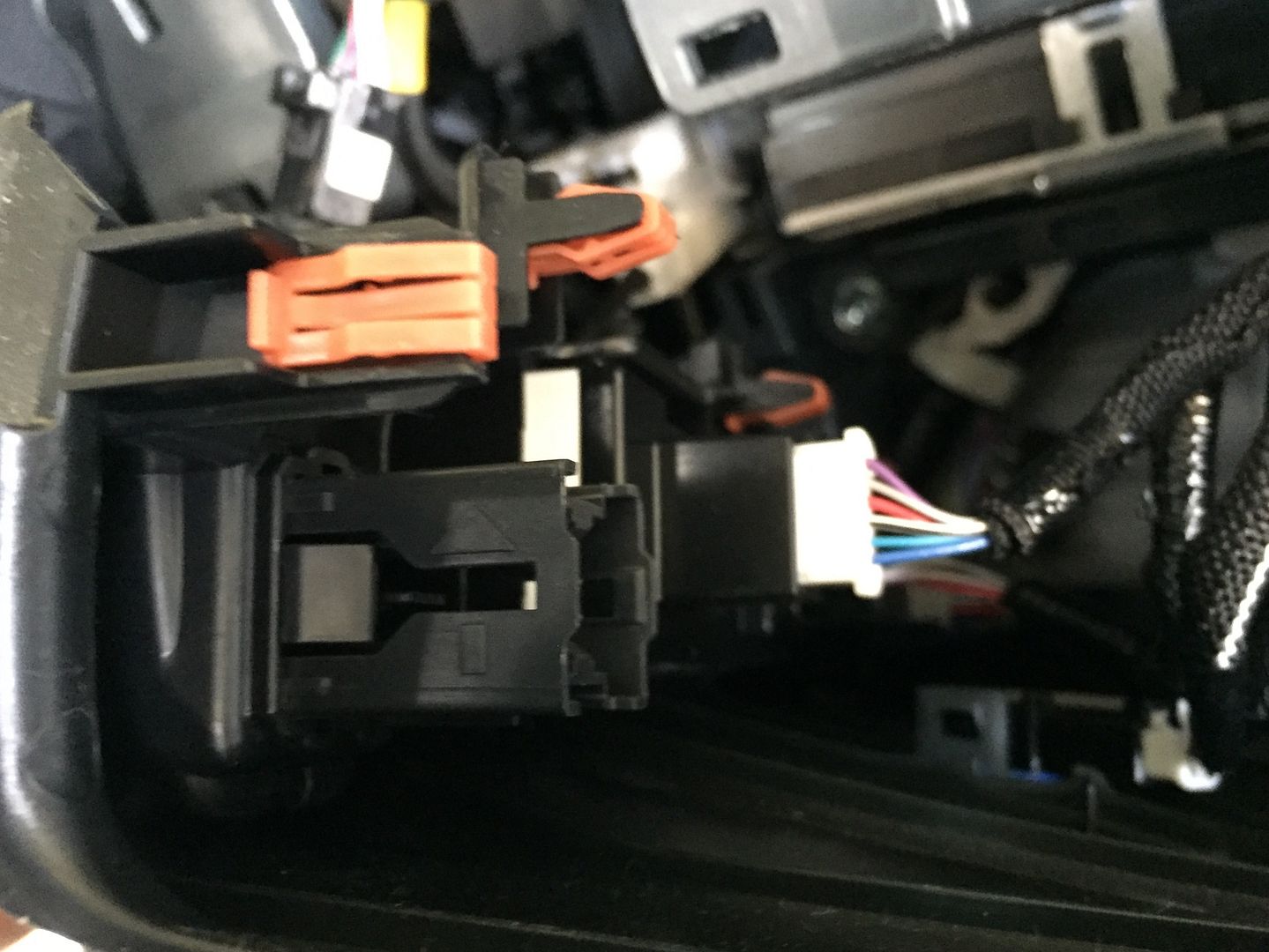

Power source: 12V DC socket on the console pad: Connect the harness to the OE plug and connect the provided connector to the AC socket and the last plug to the USB Unit

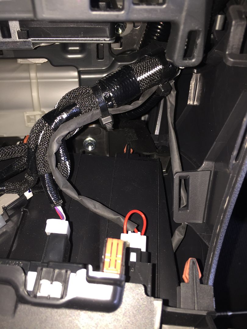

Zip tied the harness to the OE wire loom:

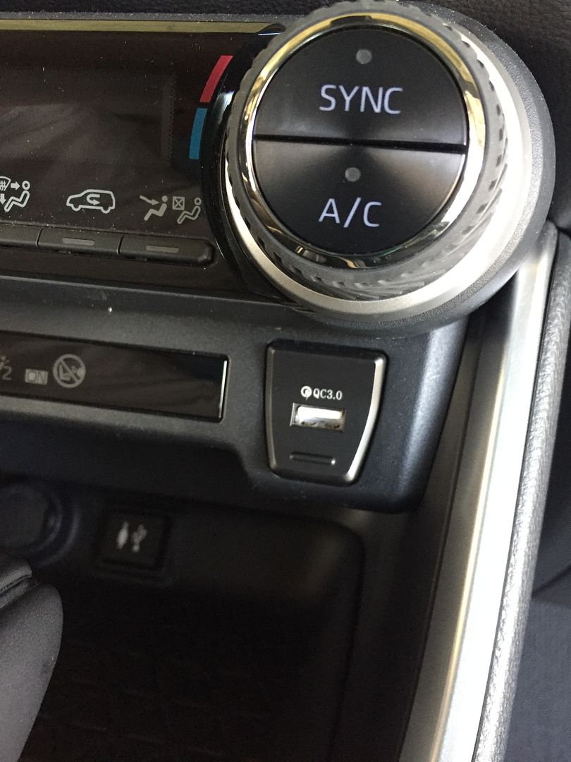

Re-install the trim pieces in reverse, Final result, and the USB port is lit blue and matches the interior lighting:
Thanks for Looking!
