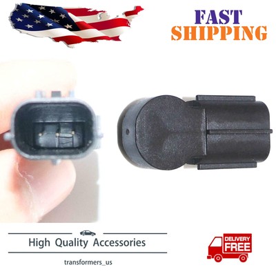

My sister's AC stopped working and the dealer wanted over $1000 to replace the entire AC compressor. It turns out the AC flow sensor goes bad on these cars, not the entire pump. eBay sells aftermarket sensors for around $40. The website won't let me post the link so just google " rav4 AC flow sensor".
You don't even have to remote the old sensor. Remove the top rad support from the car, reach in and unplug the old sensor. Then, take the new sensor plug it in and I zip tie it to the AC line. The AC is now blowing cold again.

BTW. Here's the link to the Flow Sensor for
Denso TSE17C Compressor

This is a 2010 rav4 with the inline 4. I had enough room to get the old sensor out after hours of work. I could not get the new one back in so I gave up and just plugged it in and the AC worked.
I didn't take any pictures which is a shame. It was not that difficult to get the rad support out. I believe it was four bolts. This is a family members car. I thought if I made an account and shared this maybe I could save someone a $1000 trip to the dealer.

You say it took hours to get it off. It may have been quicker just to pull out the radiator. So your flow sensor isn't even on the compressor anymore just wire tied to the pipe?
1,382 Posts
Correct, it is just zip tied to one of the AC lines.
Very interesting. So it doesn't actually get a reading directly from the compressor body.
I would have thought it had to be touching the compressor to get a reading.

I am not sure what it a actually is supposed to read. Does anyone know a Toyota technician? The shop that I do BMW coding for had no idea what the purpose of the sensor. I don't know any Toyota specialty shops.

Yup it works,did same thing a few hours ago

Left old sensor in place,unhooked the wire from old sensor plugged it into new sensor,zip tied it to the metal line.Was my nephews idea to try it.It took longer to type this with 2 fingers than to install new sensor about 3 mins. 30 seconds....lol

The AC flow sensor converts flow rate to a voltage that’s sent to the AC amplifier which communicates digitally with the ECM. So from what i gather is the sensor really is mounted on the exhaust manifold of the compressor and it is. So mounting it on the compressor line it is still reading the flow.

I took out the radiator fan/ radiator combo plus the condenser to get a clear shot at the sensor and replaced the Flow Sensor on the compressor.
