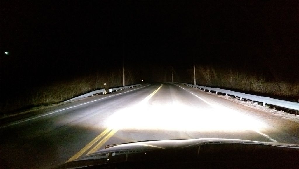

9006 is low beam...9005 is high beam...
this is whet my low and high beams look like...retrofitted 2.5 inch projectors and am using a 50 hid kit from morimoto...not cheap or easy, but well worth it...adding fog lights will do nothing for distance light...once you replace the stock bulbs make sure they are aimed correctly...if you still need more light some auxiliary should be a cost effective solution...
