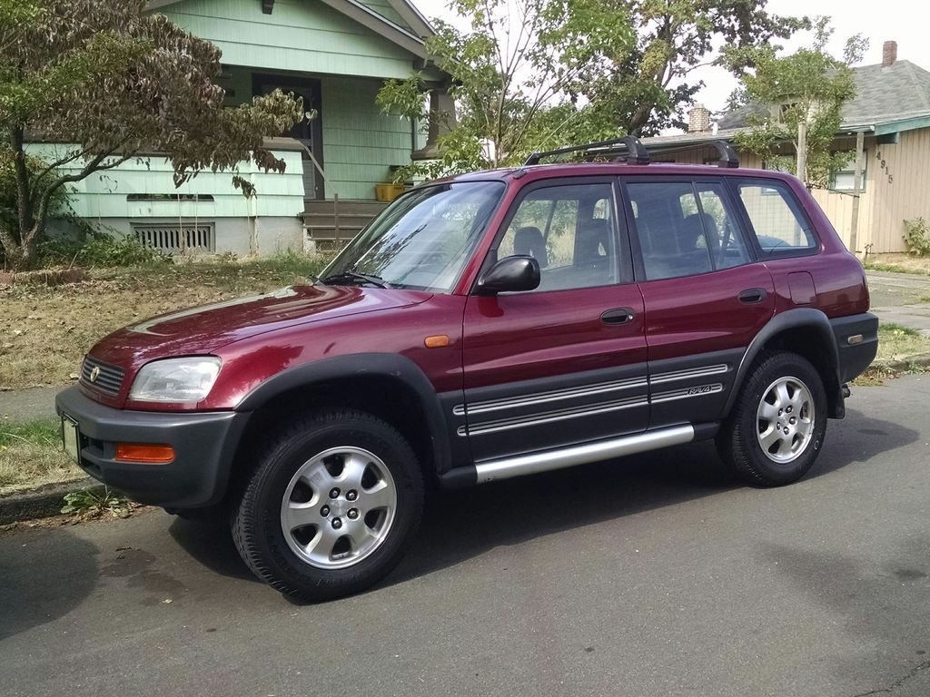

Hello fellas, not new to Toyotas but I just purchased a 1997 Rav4 that I am using as a daily commuter. I love this thing, it's been great so far. It was well maintained with only two previous owners, it has 205k miles. AWD and 5 speed manual which is exactly what I was looking for. The car is clean for it's age I'd say.
