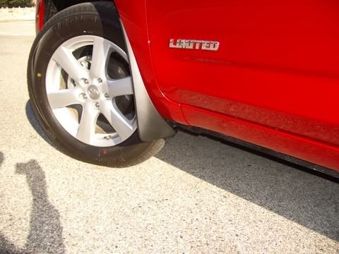

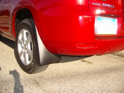

Ok people.. Installation was very easy... I work on my own cars so it was truly a breeze. All you have to do on the front is to pop in a plastic screw grommit (supplied) in an existing hole and screw on the flap with the supplied screws. The 2 fronts took all of 10 minutes.
The two rears are a tine bit harder but in reality once you digest the instructions (which makes it *seem* harder then it actually is..) its a 20 minute job. You remove 4 existing screws and pull out the rear bumper cover which snaps off easy enough with a little finese.. This is done to give you room to use a drill to dril 2 small holes that already have dimples there (thanks Toyota!) Or you could remove the wheels to gain clerance. The you put on 2 spring clips over the 2 holes on the lip of the bumper cover you just drilled. Then snap the cover back into place and put on one screw to make it tight. The install the flap with the other 3 screws. Easy and they really fit well. Im VERY happy with them.. Here are the pics.. The black flaps realy look nice due to the fact that they match the black trim all over the truck..
