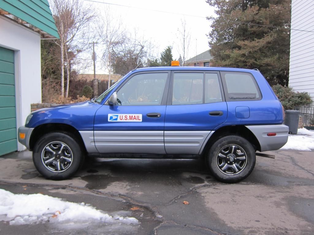

:) Greetings everyone!
Time to start a build thread for all of our USPS mods. ;)
Here she is as of Christmas time. :)
I will take more pics later today. AFTER her bath! She's really dirty right now. :rolleyes: And I will go into what I've done for mods too, with detailed pics. I might even be able to get someone to take a pic of how it looks when I'm delivering mail. :thumbs_up:

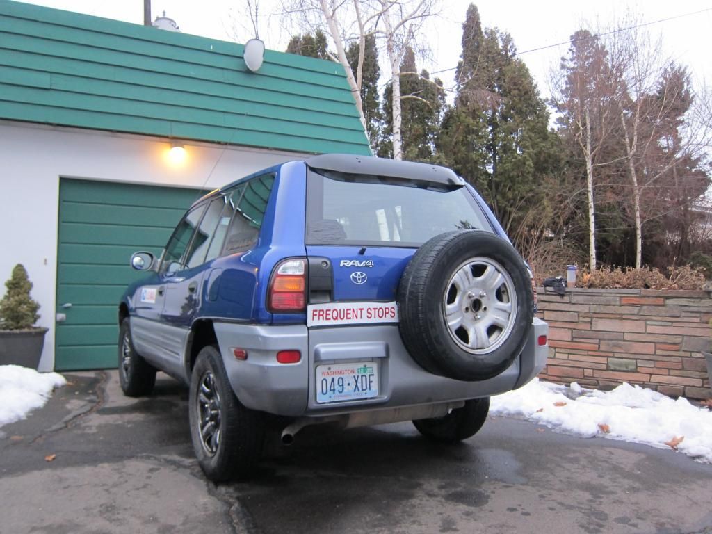

0kay, I have a few more pictures. :)
^^^^ Yes, that's the R4W sticker all covered up on the back window... :( I couldn't bring myself to take it off!!

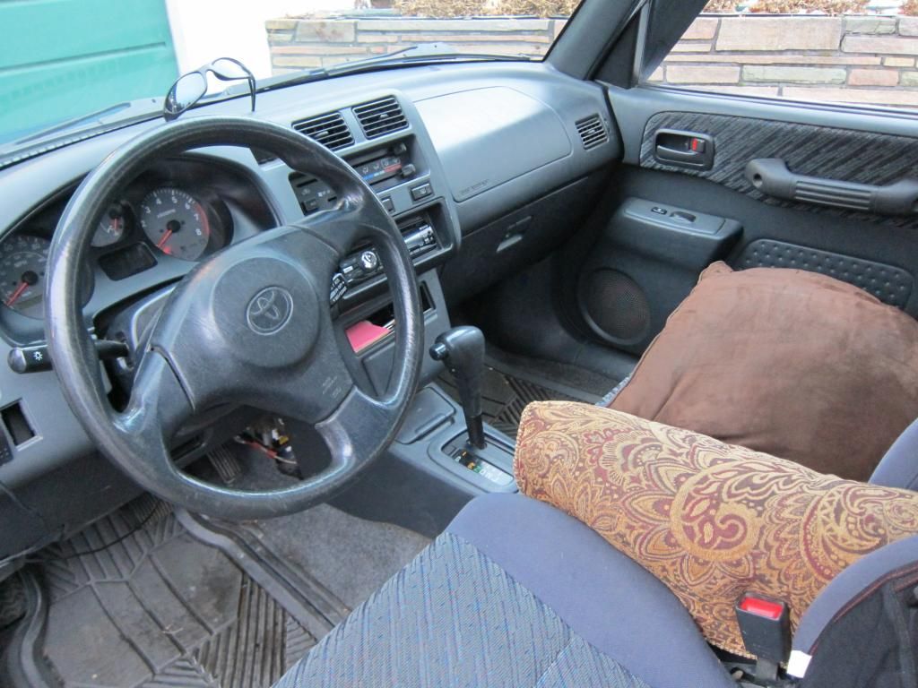

Here is my RHD setup for my LHD RAV4. ;) It's actually quite comfortable.
I sit mostly on the passenger seat, and partially over the e-brake. That way I can still reach the pedals with my left foot. (Yes, I had to learn how to drive ALL 0VER AGAIN!!! :rolleyes:)

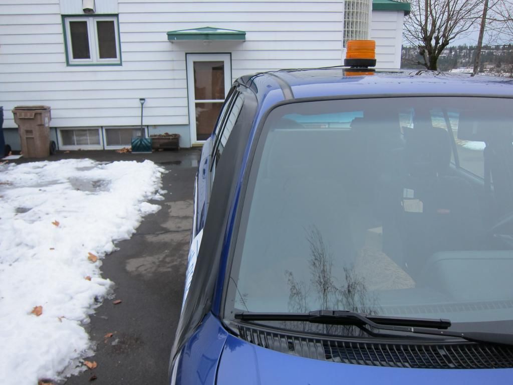

I wired in a switch to turn on my caution light. You can see the blue handle, down by the floor/side door, on the passenger side.
Let's talk about seat belts. I use mine as a lap belt. What I've done is taken a hack saw to the passenger side seat belt buckle attachment area. There are tabs on both sides of the buckle to keep it in place. I took off one of these tabs to allow it to swivel out of the way towards the back. That way I'm not sitting on it. ;) Next I buckle into the drivers side, pulling the whole length out, then I put the shoulder strap over my head and behind the seat. It works very well. :) If you have to get in and out A L0T, the whole seat belt thing tends to be a PITA!!! But safety first. :thumbs_up:

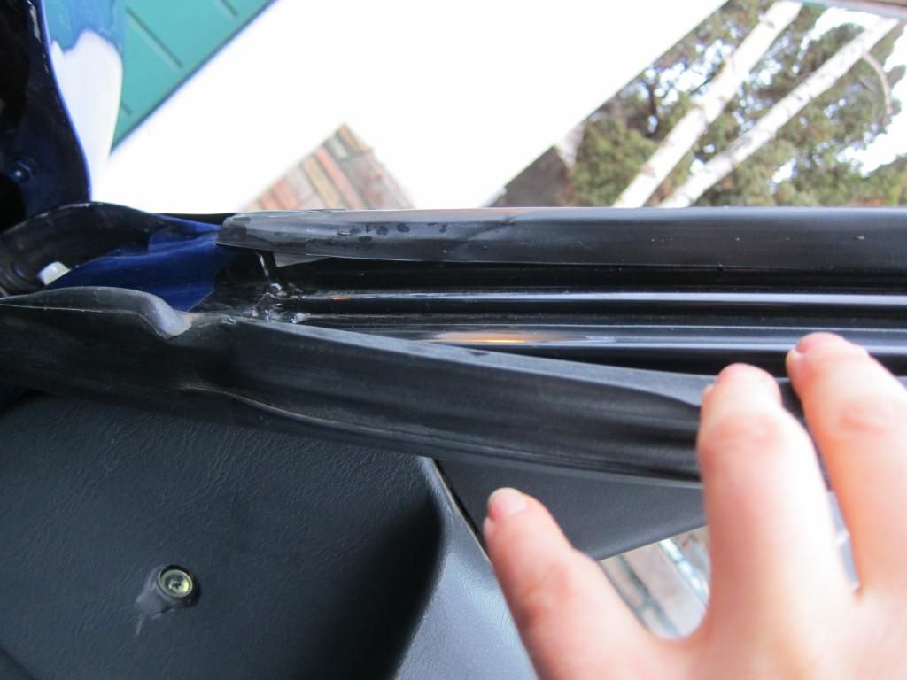

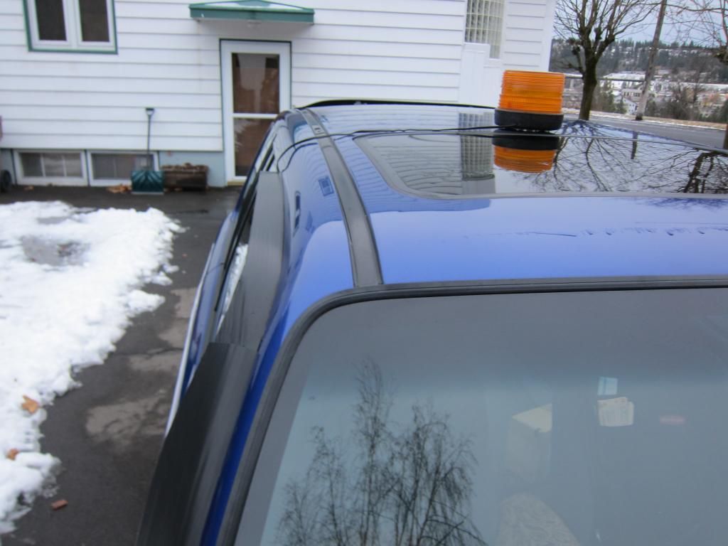

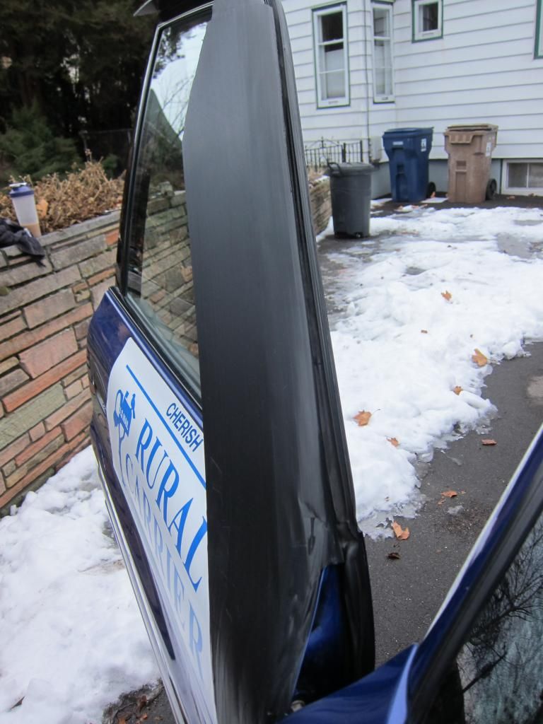

Here is a wind deflector that I made, to help stay warm during the Winter months. It works great!! :) I leave my window open the whole 80 miles (5-6 hours of driving). 90% of the wind is completely deflected from even coming inside the open window.
I used coroplast, and a heat gun to make the deflector. It was easy, cheap, and fun to make. :)
I also added a rain deflector along the top. However, that hasn't been tested yet. It's only rained one day that I was delivering, and that's when I knew it was something I needed to address.
I have a small tab along the length of it, to wrap around the door frame where it's attached via 3M Tape. It's simple to move the door gasket out of the way to do this, and to put it back in place, once finished.

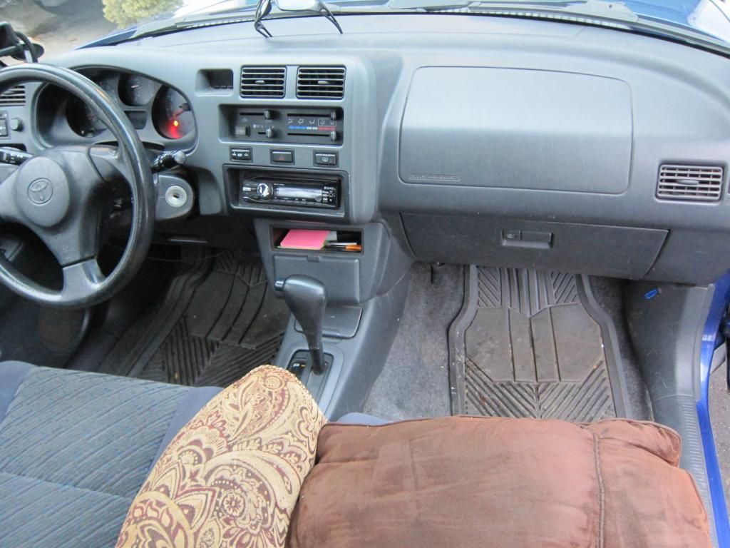

Here is a handy thing I happened to find at Wal-Mart of all places... :eek: Not sure what I was thinking by being there, but that's another story. I use it to store 3849 forms, books of stamps, markers, pens, etc. It will be able to be used more, after I install the RHD conversion kit. Right now I leave it there and drive from the driver's seat when I'm not delivering. Having several things in there can make it uncomfortable. But having paper things stored there is great!
I use the tubs that the flats come in to deliver from. Using a criss-cross method. The letter trays don't fit on the seat, and I can't stand fussing with rubber bands, or straps. :rolleyes: The tubs are also a perfect height to rest my arm on while steering. My arm doesn't get tired from the reach one bit. :)
