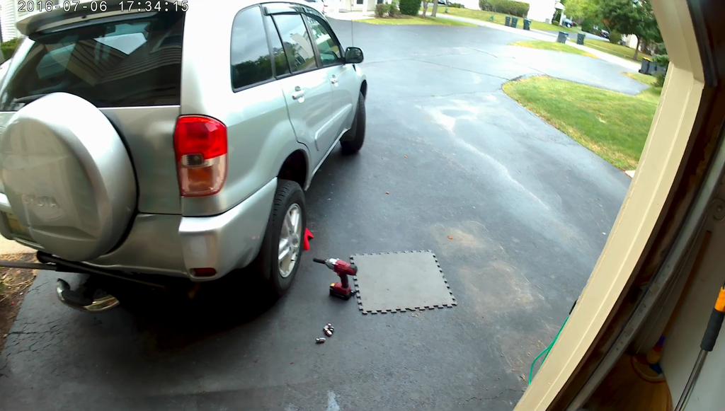

Hi again. Couple of weeks ago my second wheel bearing on the rear passenger side got shot. The shop quoted me $250 for replacement so I decided to do it myself and share my experience with others. I hope this can maybe save someone few bucks as you can definitely do this yourself. This is for 02 Rav4 with two wheel drive and 211K miles on it. This is also my second bearing I did as the first was the drivers side rear back in September of '15.
First time I've noted the weird howling sound coming out of the back of the car when i took the car to get some gas. My wife drives the Rav4 daily and she had never noticed anything unusual about it so I am not even sure how long has she been driving on a bad bearing. Anyway, this is how I did change it;

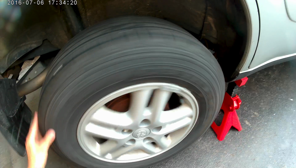

First, I lifted the back of the car and spun the wheel, right away I could hear and feel the grinding and hauling noise while spinning the wheel. The wheel also had a big play when pulling and pushing the wheel at 12 and 6 o'clock.

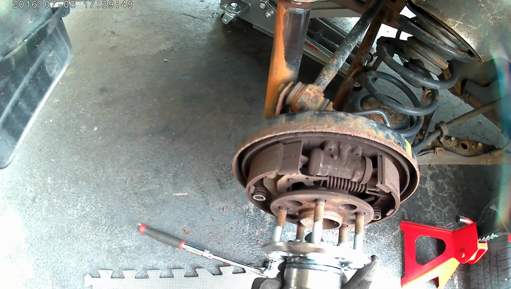

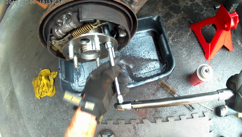

3. Next, to take out the hub assembly you have to take out 4 14mm nuts that were holding the bearing hub to the backing plate.

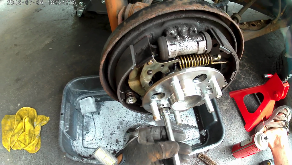

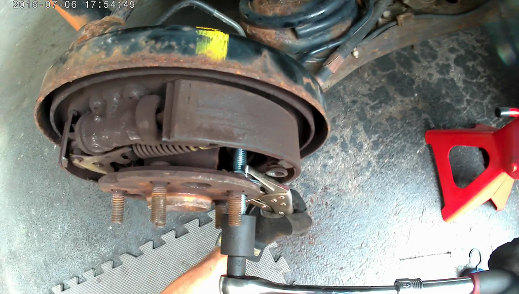

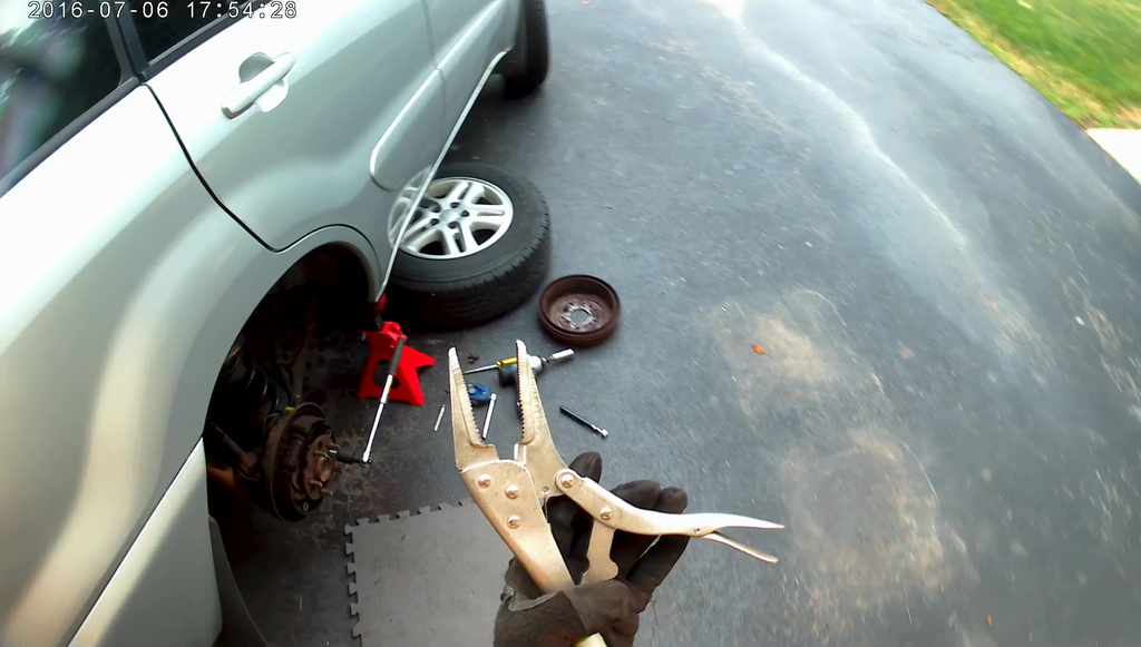

Next step is to attempt to separate the hub assembly from the backing plate. To do this, you'll have to stick the large bolt through the big hole of the hub and rest it against the backing plate and not the inner part of the hub. Then, insert the washer on the other end of the bolt behind the hub, following with the nut. Screw the nut alaway up to the back of the hub so its tight. Next, use a large socket and start turning clockwise slowly, until you'll start seeing the inner side of the hub start lifting away from the backing plate. Eventually you'll hear a thump when the one side gets released. To actually do this successfully, you have to hold the nut with something so it doesn't spin with the bolt as you turning the bolt clockwise, forcing/lifting the hub away from the backing plate. To do this I used long nose pliers that easily fit in the tight spot behind the backing plate and the brake shoes.

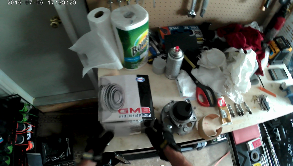

Next, after you'll get this bearing assembly off of the plate is best to measure and compare the old one bearing to the new one. I got the new one from Amazon by company called GMB with part #770-0251. This assembly came with the ABS sensor already installed and this was also my second bearing from that company. So far the first one works great and only cost me $46 with free shipping!!!! Cant beat that...

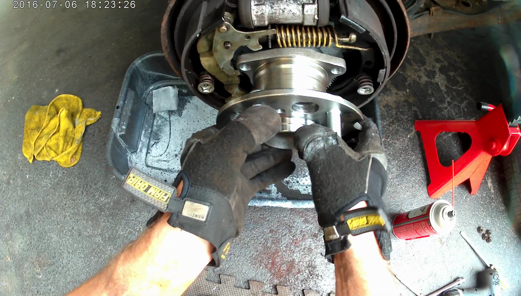

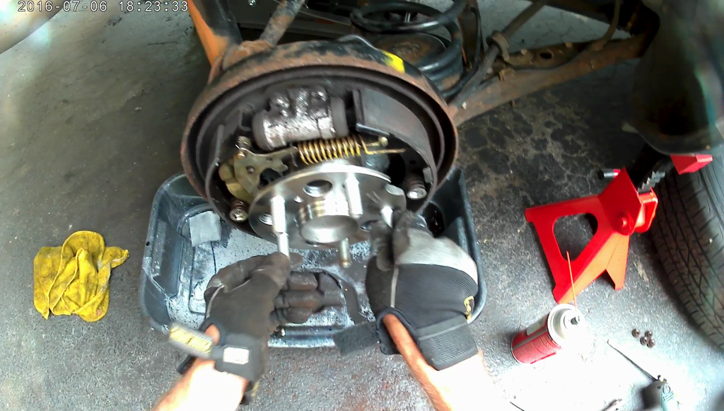

After you've determined that both bearings match, attempt to clean the inner side of the backing plate, put some anti-seize and thread locker and reassemble the new hub assembly back on the car.
Finally, make sure to torque the 4 nuts that hold the Bearing Hub Assembly to 37 foot Pounds and reconnect the ABS sensor behind the backing plate. Everything took maybe 2 hours and saved me $200. I hope these picture help someone to do this DIY. Cheers!!
