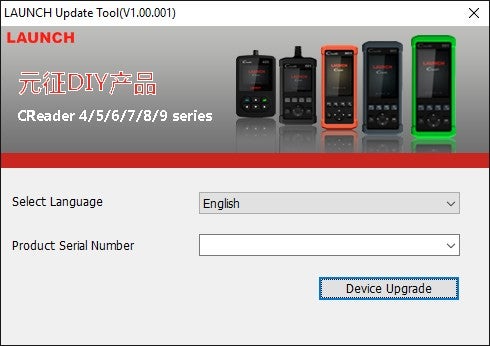

The unit can be updated in 2 ways: by removing the microSD card and using the included reader to write the update files directly to the card. Or you can use the USB cable and update the files directly to the scanner.

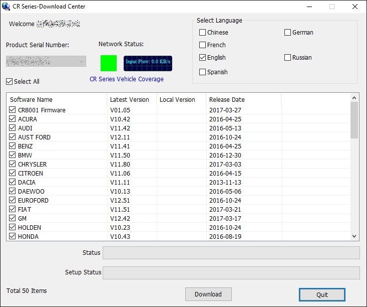

To download the updated firmware and diags, use the Launch Update Tool:
From here you can see the latest firmware updates, as well as the newest vehicle specific diagnostic files. Launch updates these files regularly as new models come out:
After updating the files, a reboot of the scanner will ask if you want to upgrade, choose OK for yes:

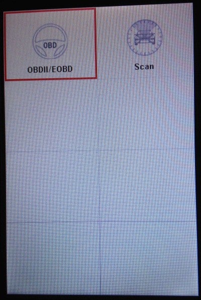

Clicking on Diagnose will bring up two options, OBDII/EOBD and Scan. Choosing OBDII will bring up the generic code reader for any vehicle. Choosing Scan will allow you to scan manufacturer specific codes, like Scion/Toyota:

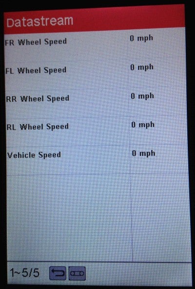

By choosing ABS, you can look at wheel sensor data live as the vehicle is being driven. If a wheel sensor is bad or acting up, you will see it immediately:
The data refreshes about 2 times a second making it easy to troubleshoot and diagnose most problems. You can check the status of all ABS related switches and see them respond in real time:

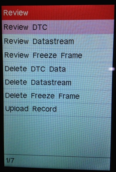

Once connected, a menu will allow you to choose to review codes, review live data in the datastream, review freeze frame data, and upload data to a computer or printer:
If you choose Review DTC, you get these choices:
You can also use the 4 buttons on the front panel to go directly to DTC codes, Erase codes, Inspection/Maintenance readiness, or Help. Under the Help menu, you can enter any code and it will look it up, even manufacturer specific codes:

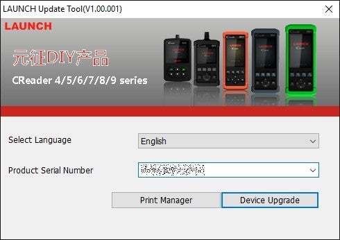

Now, suppose you have saved data that you want to transfer to your computer. Here I have a few sessions from my RAV4 along with several from a 2015 Chevy:
At this point you would connect the scanner to your computer and run the Launch Update Tool again. After entering the serial number of the scanner, you will get the Print Manager option:

After clicking on Print Manager, the ScanPrint utility will appear allowing you do download saved data from the scanner and save it as a text file or print it out:
