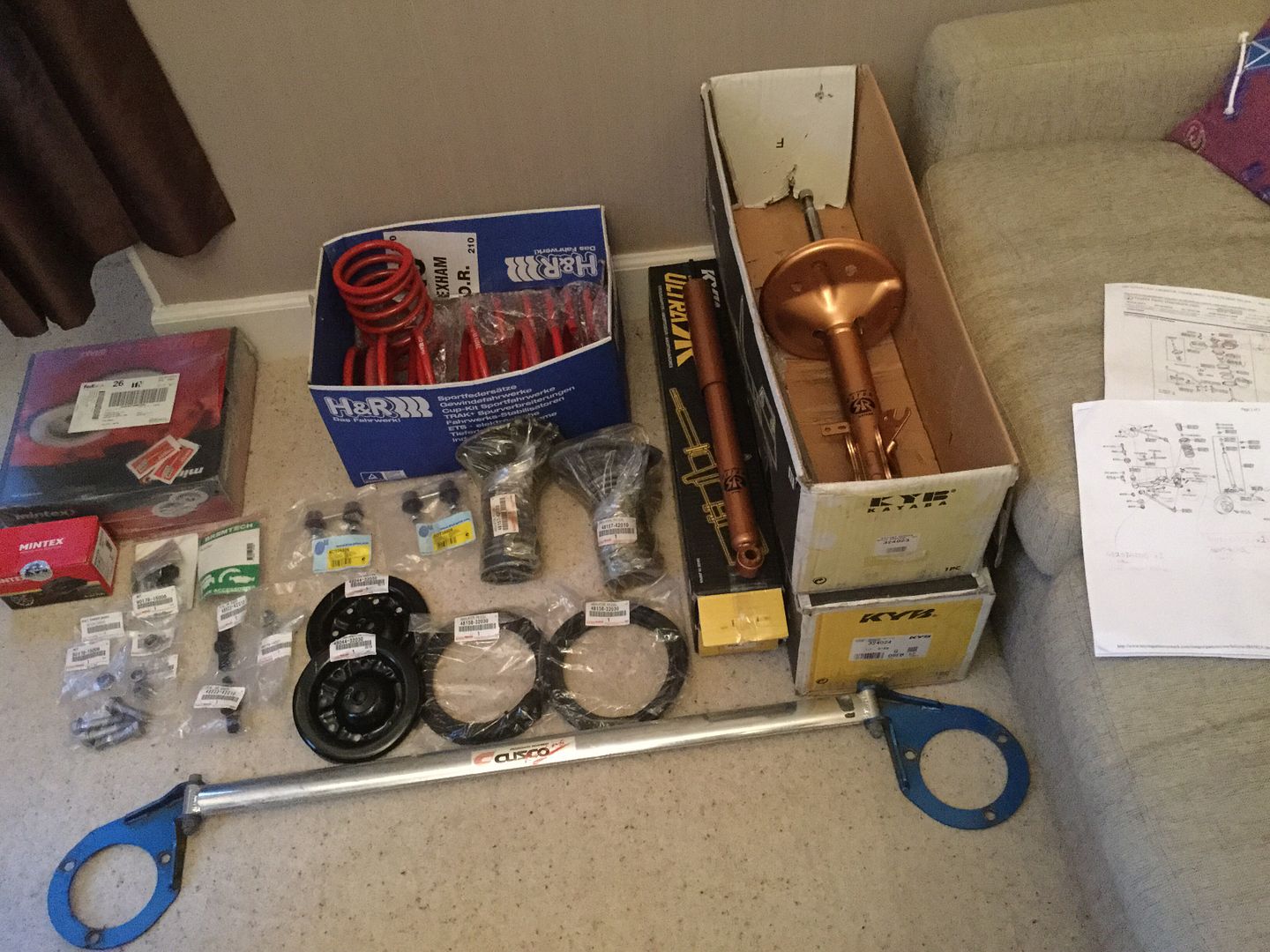

Hi, I've just fitted today new springs, H&R -30mm all round with KYB Ultra SR shocks all round, the rear shocks were about 2" shorter than previous ones but when the Rav came down off the lift, the shocks sat perfectly with the springs, not overly extended and not too far compressed.
I had a 35mile trip home from garage and Rav handles fantastically - wasn't crashy at all and took the bends with ease and could maintain speed (not that I was thrashing it or anything).
They are oil shocks, the previous on the rear were gas - to me the new ones are better ride - wether that's down to being a good match in length or being oil, I'm not sure but I can definitely vouch for this setup and they clear my 225/55/17 setup.
I can take some measurements from arch to wheel centre once I get it back tomorrow from exhaust fabricator if you want?
There you go man. Drive on, drive hard. You're getting ready to do battle and your on your way:thumbs_up::thumbs_up::thumbs_up:

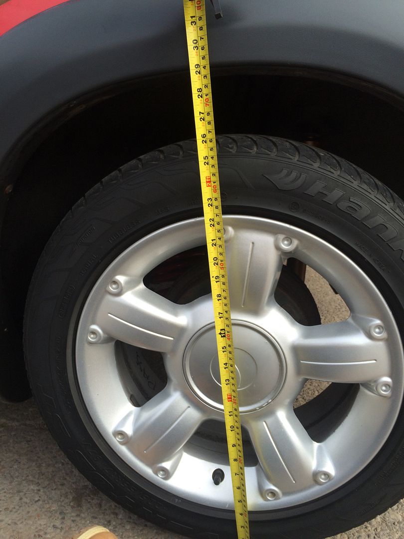

Il measure that tonight and get a pic for you.
Alright man. Thanks!!! ^_^
No bother, what size of tyre are you running?
We can work out difference from mine as I know my overall diameter is slightly smaller than OEM.
I'm running on 235/50ZR18s, smaller overall diameter than the OEM 215/70R16 if I'm not mistaken. :)
Hi,
I'm 75mm gap from top of tyre to arch and 740mm from ground to top of arch.
Would need to adjust slightly for your size of tyre, that's me with 225/55/17.
