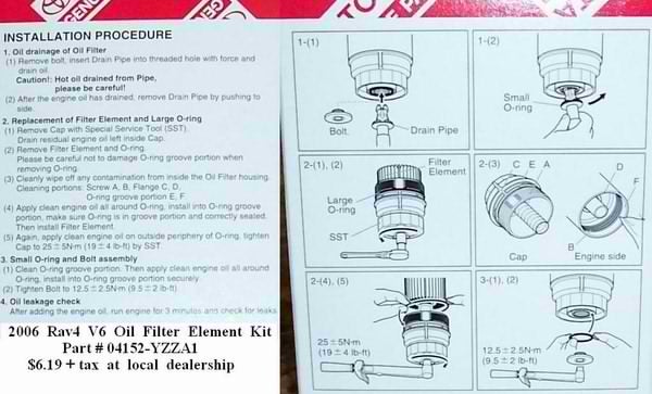

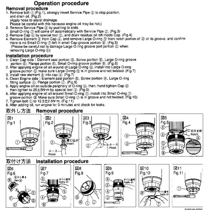

I have scanned and placed the instructions in my album, look at removal line 3, it says to remove cap with special tool marked item #3 in figure #4, it looks like a standard oil filter "cap" type socket wrench tool, is that what this special tool, is?

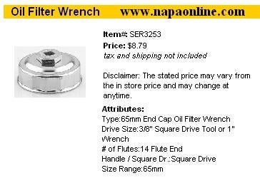

Filter canister takes a 65-67mm, 3/8 drive cap type of filter wrench, as described in PDF previously posted on changing oil in the Avalon (same engine as RAV4.3 V6) Just did mine this weekend and it fit like a glove!

The 65mm tool from Napa fits perfect, no need to do any cutting, but if you already have the multi fit tool, why not. :wink:

They don't know what they're talking about, although it works there, it's not solely what it's intended for. The bottom right graphic shows exactly where it goes when reinstalling the drain cap.

So I'm going to purchase KD Tools' metal 65mm filter wrench. It wasn't available at my local Napa store. Searched several online dealers, including Napaonline.com. The cheapest shipped price I could find is:
http://drivewerks.com/catalog/ShopCart/TOOL/POR_TOOL_CAT213_pg5.htm
It's $11.17 shipped.
1,786 Posts
I found out today that the steel NAPA tool is discontinued, replaced by the resin 65/67 mm version. I bought one of those, cut it down and it works just dandy. All I can surmise is that others who had problems with it didn't get it on far enough, or there was pre-existing damage to their filter housing. Mine fits so tight that I have to wiggle it off using the extension.
The NEW part number is NAPA P/N 3860 (made by KD Tools)
Beware of cheaper resin versions without the steel insert in the drive hole - they can break at that spot without it. I still wish I had one of the old, all steel versions...
When you install the tool over the housing, rap it with your handle so that it seats tight onto the flats, and you shouldn't have any slippage problems.

I just ordered the KD3253 all metal 65 mm from Amazon for $6.44. If you order $25 or more of you get free shipping. :D
