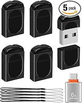

I've been using several different brands of thumb drives in my 24 XLE without issue. Recently bought these no name drives and they work just as well.
