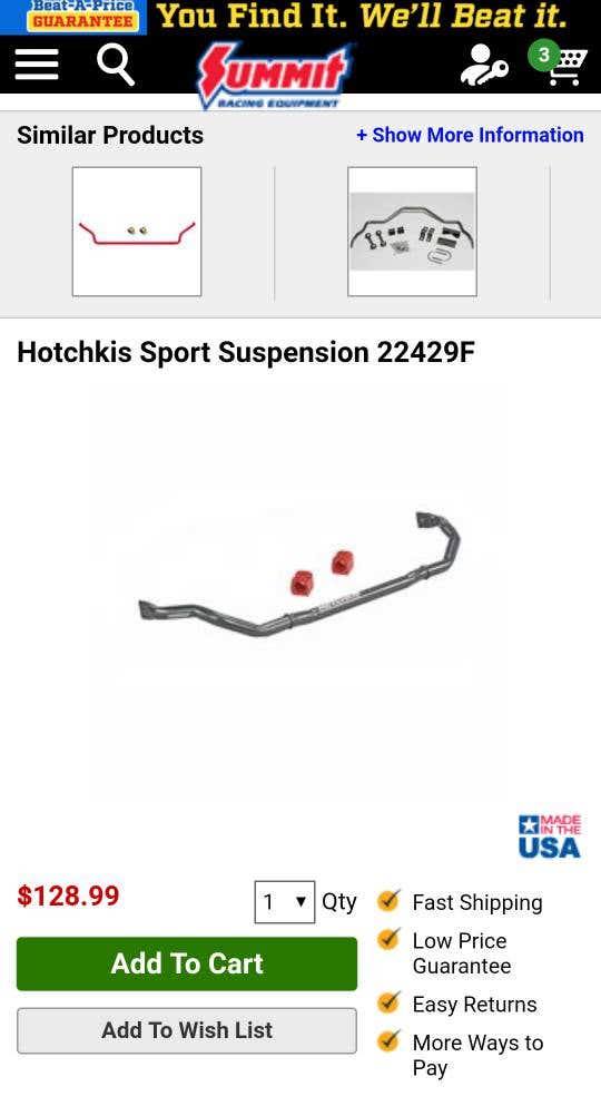

I have Hotchkis adjustable sway bars on my IS300. Which I have set to soft, farthest setting.
160006

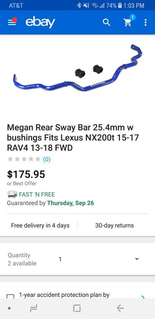

Well, I've been having a difficult time locating any of the verified rear sway bars stateside. I found one about 3 weeks ago then it disappeared. Other compaines were out of stock. They have 3 in Japan and Australia but $120-150 shipping and returning the sway bar are a little sketchy. Any recommendations?
BTW, Teksmart, I'm in the Dallas area if you want to meet up sometime. I would love to check out your ride.
Discussion starter · #56 · (Edited)
RSB are still available for from RHDJAPAN.
If I remember correctly, @84hachi and I both bought ours on sale for around $275 from RHDJapan so anything under or around $300 isn't bad at all.
Nice! Yeah I agree $300 is good. I just wanted a reliable supplier in case I have to return or whatever. Thanks. I’ll probably be using these guys.
