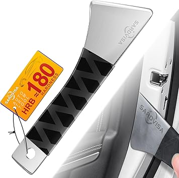

I read many of the reviews of the various brands of trim removal tools. The 1-star comments say that the plastic ones are flimsy and break easily. I prefer to get tools that last longer, in case I need to use them again. Based on their reviews, their descriptions and their metal composition, these two removal tools on Amazon seem to be better:
