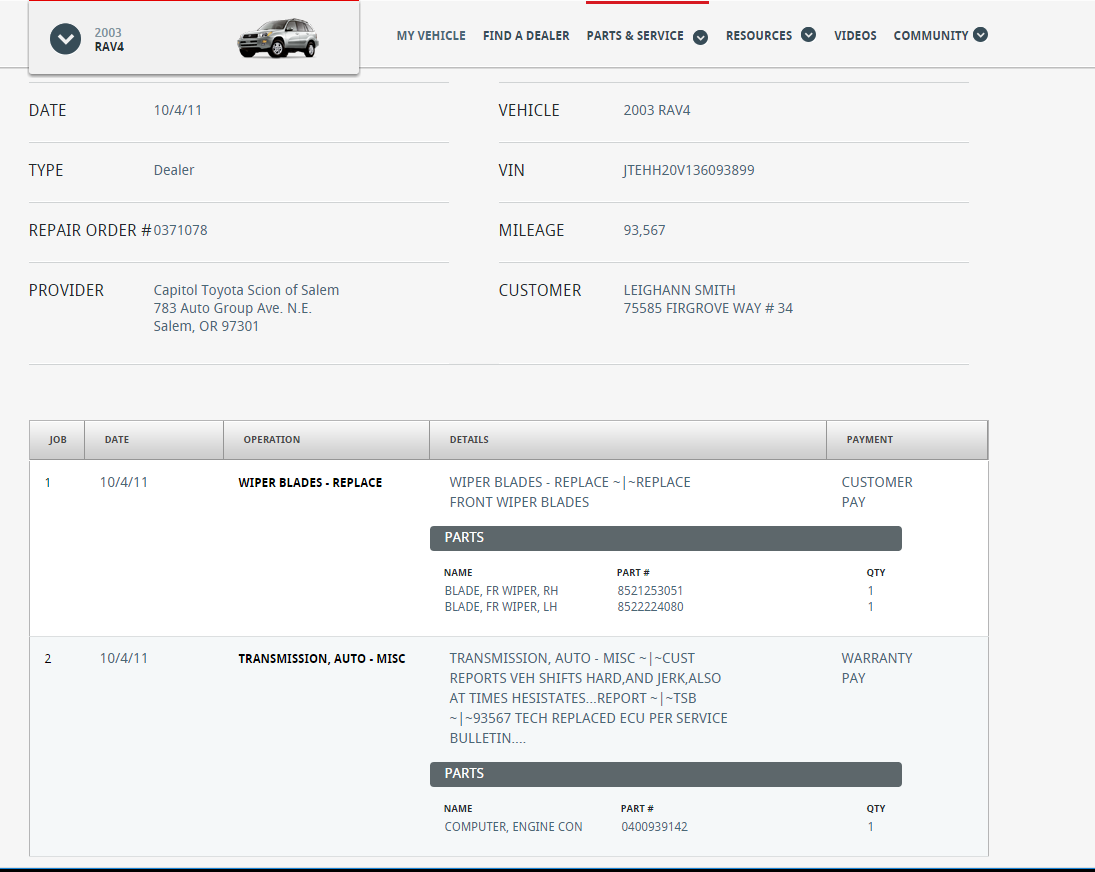

Hey typo! I was reading here on the forum earlier today, when I ran across a post saying one could go to this website: https://ssl.toyota.com/owners/login?#
and see a history of repairs/services that had been done. A list of services and repairs came up alright... kind of cool really. And it say's that on 10/4/11 the ecu has been replaced as per recall. I'll try to post a pic of it, if I can. It's under service order #2. Now who knows if they "really" replaced it or just flashed it? But that was one of the last service records on my vehicle.
